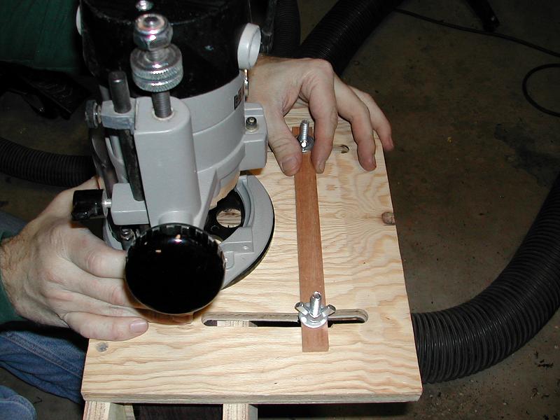

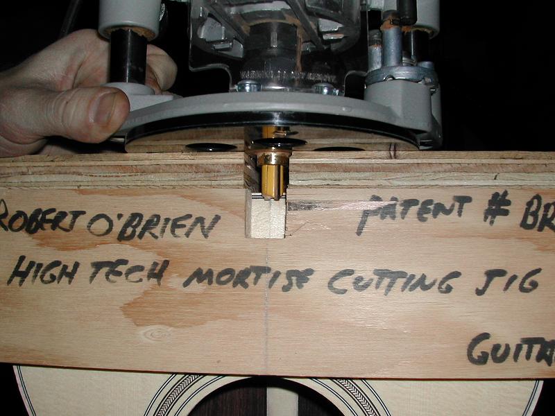

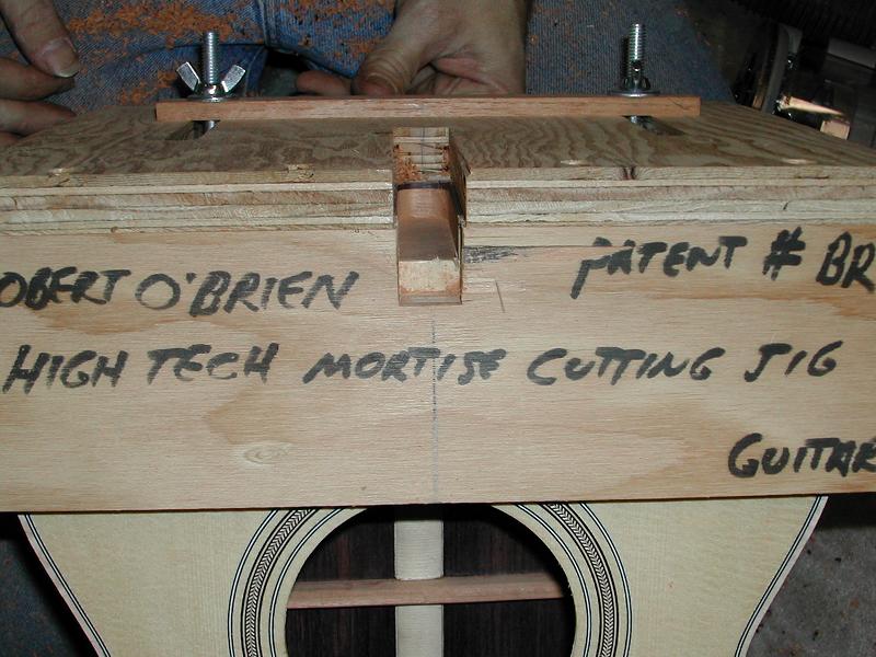

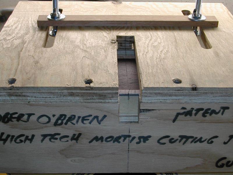

Here is the one I use Tom. It is very simple to make and it does the trick. Check the jigs section for a neat tenon cutting jig from Paul Woolson.

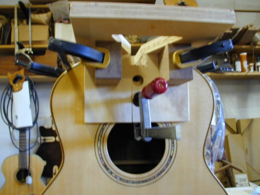

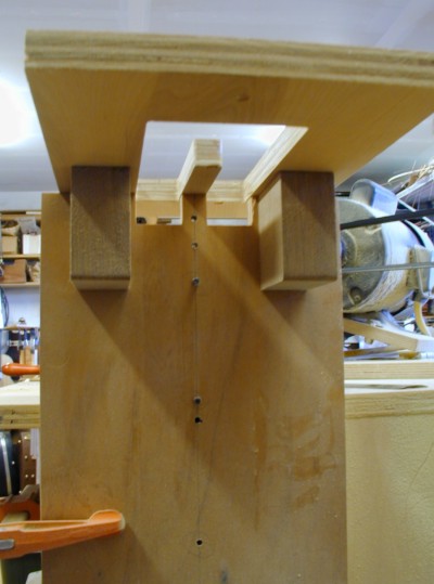

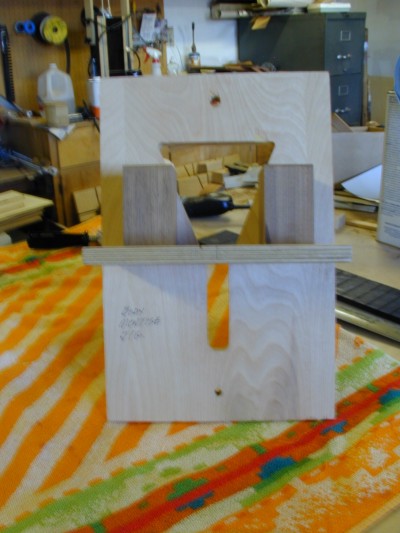

Here are some photos of the jigs I built. All jigs utilize a 1/2" pattern router bit with a top mounted bearing. All cut are made with 3 passes.
This is the neck tenon cutting jig. The neck references off the truss rod slot.
Here is the mortise cutting jig clamped in place on the guitar body.

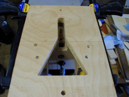

Top view of the mortise cutting jig.
Bottom view of mortise cutting jig showing the plate that sits on the top of the guitar above the soundhole and the actual mortise cutting guide slot.

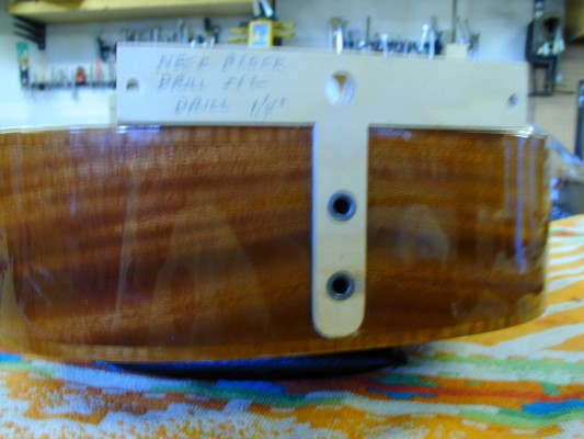

Here is a fuzzy shot of the bolt hole locating jig. It slips into the mortise and has two 1/4" drill guide bushings to locate bolt holes in the end block.

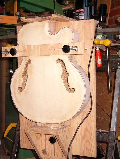

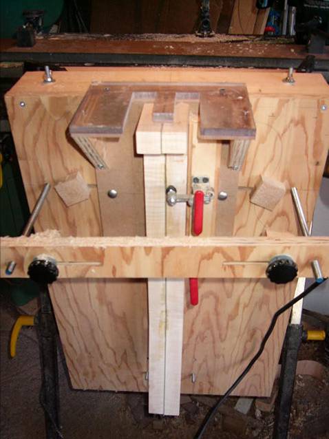

Tom I have built the Moll jig you referenced above and am really happy with its accuracy and versatility as it is readily adjustable for whatever body size you building.    Mine is built to be clamped to work table and I can easily remove the mortise attachment and attach my neck tenon jig. Also with the mortise attachment removed it makes a great body holder for sanding the ribs or scraping bindings.

I just built my jig for doing the mortise block, I slot mine before I glue it into the body, in the my mold I have a piece of UHMW that aligns the mortise and allows me to trim the sides to be fitted up against the block. One difference is that mine runs all the way through like Cumpiano's does, this makes fitting all this much easier for me, however I *REALLY* like hanks jig for drilling the bolt holes and may steal that idea from him, now I shave off the thickness of the soundboard when drilling the mortise block, but his jig removes that step... Love It
